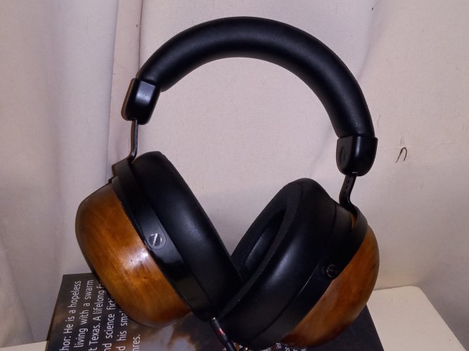

I recently purchased these HE-R9 headphones, for the heavily discounted price of $109, and even at that price I wasn't really pleased with their sound. They were odd headphones, with good sound on certain tracks, and some awful results on others. The main problem was a boomy sound in the bass/lower mids that could overwhelm everything else.
You can see them here: https://store.hifiman.com/index.php/he-r9.html or here: https://www.head-fi.org/threads/introducing-the-hifiman-he-r9.961867/
The interior of those huge cups is angled away from the driver, but the driver itself sits square, parallel to your ear. Hifiman has a thin sheet of foam directly behind the driver, but nothing else. It is a big, cavernous space, with lots of reflective surfaces. My first thought was to line the interior with foam and see if that made a difference. The result? Possibly better, but it was a minor change in the sound. I found that EQ was a better solution, but even there, I wasn't satisfied with what I was getting out of the headphone.
So, naturally, I decided to dive headfirst into modding these things. Might as well. I had a thick piece of cherry in my shop, and I decided it would make a couple of cups for this headphone. There was one interesting problem in the way. I have been a woodworker most of my life, but never a wood turner. I haven't got a lathe. So, making round blanks to a specific size was a challenge. I wouldn't advise turning your drill press into a makeshift lathe, but it does work. Once I had the blanks, it was easy to cut and shape them on my router table. They aren't spectacular cups, since the wood I used is just plain cherry, and not figured wood, but they are good enough for my purposes.
The original cups fit together on the driver housings with a little lip that I couldn't reproduce on my wooden cups, and this turned out to be a happy accident. Screwing the wooden cups on the housings leaves a small gap, which makes these headphones semi-open now, instead of closed back. And I believe this is the key to the better sound I'm getting. The straight space behind the driver (instead of the original angled space) did change the sound, and perhaps the wood helps too, but I'm pretty sure the drivers are doing a better job with a little more air.
There are downsides. The cups I made weigh about 96 grams each, while the original plastic cups were 39 grams. So, they are heavier overall. There is less isolation, and I believe, slightly less bass impact. I need to do more testing to be sure of that.
Here's what they look like:

Still fine tuning these. The bass is definitely reduced, and this version of the HE-R9 can no longer be considered a bass-head type of headphone. It's pretty close to what I want though, since the bass hits without being intrusive, boomy or bloated.
I was getting some unexpected treble spikes, so I started experimenting with different materials in front of the drivers. The felt I'm using now is working better than I expected.

The Brainwavz velour pads arrived, and I made a mounting ring system for them. With this in place, I can use any oval pad that has the same type of attachment... in other words, any pad with the little flap of vinyl that fits into a slot or stretches over the cup.
Since I had to wait for the pads, I was using my CAL! for the last few days, and going straight from my CAL! to this modified HE-R9 shows me that I haven't tamed the bass entirely. That might not be possible, and these headphones will always be a "fun" set, and will never have super resolution and clarity.
I don't intend to do many more physical adjustments in the near future. Doing everything by ear is difficult. Making minor changes and looking at the frequency response charts would be much easier, but I don't have a testing rig, and don't feel like spending $300 to get one. I'll take a few days listening to what I have now, and maybe I'll try doing a few adjustments through EQ.
In any case, I much prefer the current sound compared to the original. I don't think I could have adjusted the sound to a acceptable level while using the original cups. Look at JM Audio Editions. They modify headphones as a business, with a lot more equipment and experience than I have, and it has taken 8 iterations of their mods to come to a result they think is good while using those original cups. Doing that by yourself would be an exercise in frustration.
All my mods are reversible. If I needed to put these back in the original configuration, I could do so, but I don't think that is going to happen, not if I am the one listening to them. So, is there anything I'd do differently? Absolutely. I've already made one small change, by removing the felt over the driver. Didn't need it with these velour pads for some odd reason that I can't really explain. But there are a few other changes I'd make. The pad mounting system I made is egg-shaped, but I could have extended it a little more towards the bottom of the cup. Didn't know beforehand if the pad's vinyl flap would stretch enough, but it would have. Also, when I cut the interior of the cups on my router table, I was making blind cuts, and was very conservative on depth. I could have shaved off another 10 or 12 grams of weight from each cup. That's ok. It was a learning process, and I'll remember that if I ever make another set.
Hope this has been informative, or at least, entertaining.
Edit: Didn't take long to come to the conclusion that the velour pads weren't working all that well. Oh well, that's par for the course when experimenting. I'm back to the original pads now. I'll use the Brainwavz velours on a different headphone.
