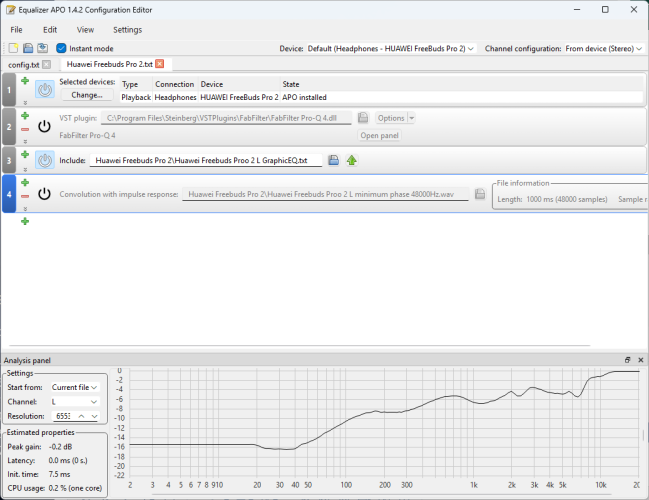

@jaakkopasanen, bug report: no matter what sample rate I select for an output convolutional EQ file in autoeq.app currently, the resultant file is always 44.1Khz.
Also, and this may not be a bug, but whenever I convolve an audio file with an impulse .wav from autoeq.app, the volume reduces by a huge amount: about 20db.
