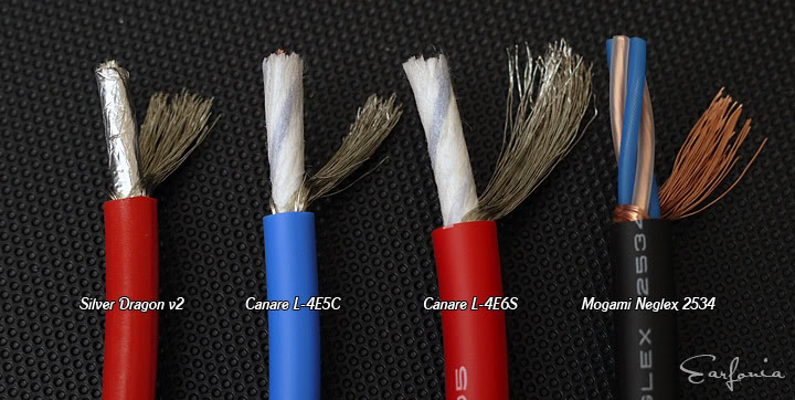

I did some experiments, recabling my M50. The original M50 cable has 3 conductors, 1 wire as ground wire for both left and right. I want to know if replacing the 3 conductor cable with a starquad (4 conductors) cable will help to reduce the crosstalk. With starquad, I can have 2 wires for ground, one for each channel, separated from the mini jack end.
Here is some pictures of M50.
Original wiring:
I modified a little bit to hear if by bypassing the left driver pcb will give any audible difference. No audible difference heard.
I search for small starquad, the only model available in the shop is Canare L-4E5C, and only blue color available in stock. This cable is actually a bit to big in diameter, cannot go in fully into the M50 left driver enclosure. I know that Belden has smaller starquad, they call it micro starquad, but not available here.
I use blue wires for ground. At the minijack end (I use Neutrik), I combined the blue wires and the shield. At the driver end, I use one blue wire for each driver.
The result is good! The crosstalk has been significantly reduced
The two wires ground with starquad cable is proven to reduced crosstalk significantly
But I have another problem with this cable, I can hear microphonic previously not heard with the ATH-M50 original cable
But that's ok, I don't move around much when using it
