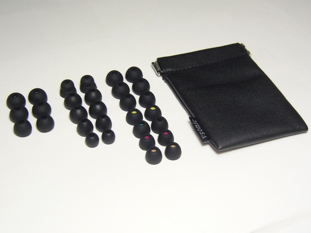

Tips & pouch
The GR01 ships in VSonic’s simplified new packaging – a clear plastic outer box with cardboard and foam inserts displaying the earphones and obscuring the accessories. The accessory pack consists of 15 pairs of eartips and a padded spring-clasp carrying pouch. The tip set includes seven pairs of Sony Hybrid-style tips, all in different sizes, as well as 3 pairs of foam-stuffed Hybrid tips and 5 pairs of standard silicone tips, including a bi-flange. The soft carrying pouch is very well-made, probably the best I’ve come across, but I would still have preferred a clamshell carrying case like the one included with the 1st-gen GR07.

Tips & pouch
