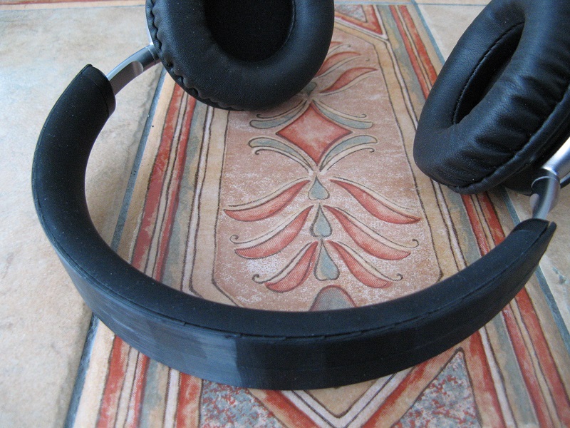

Roccat Khan
The headband for this headset snapped, so I replaced it with a Logitech G Pro headband, printing four adapter pins to make up the difference between the earcup and headband fork sizes.

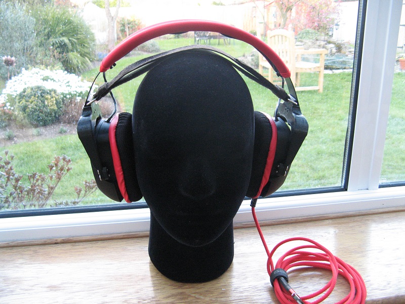

Logitech G332
On this headset the swivel retaining tabs had broken, so I found a model online for the replacement part. Unfortunately it wasn't quite right, as it was for a similar, but slightly different model. However with some adjustment using a craft knife it was made to fit. I suppose I could have modified the original model to better suit this headset, but since this fix works it wasn't worth spending any more time on what is a fairly budget headset.

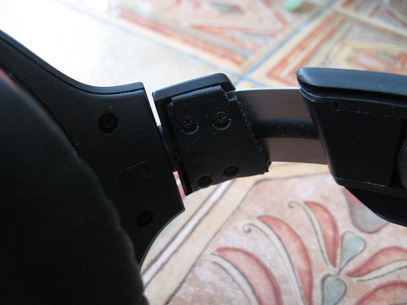

Roland RH-5
One of the forks had snapped at the fork to headband swivel, so I printed a pair of replacements.
