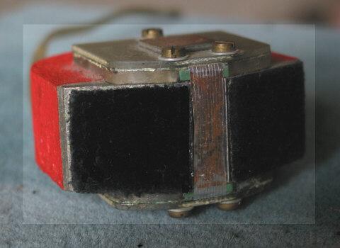

I have already mentioned samarium cobalt, but its price is very similar to neodymium, and from the stability I consider it less suitable for open magnet bars. Ferrite is by far not strong enough for planar headphones (moreover the magnet bars in the HE1000 don't look like it). From what I know Alnico isn't used for headphones at all. Its flux density is too low as well – and it's prone to lose its magnetic flux through mechanical shocks. I used it for a homegrown transformerless ribbon supertweeter myself (with the typical horseshoe shape) and had to realize that the resulting efficiency was much too low – but the sound was stunning nonetheless: very impulsive and fast, almost plasma-like.
