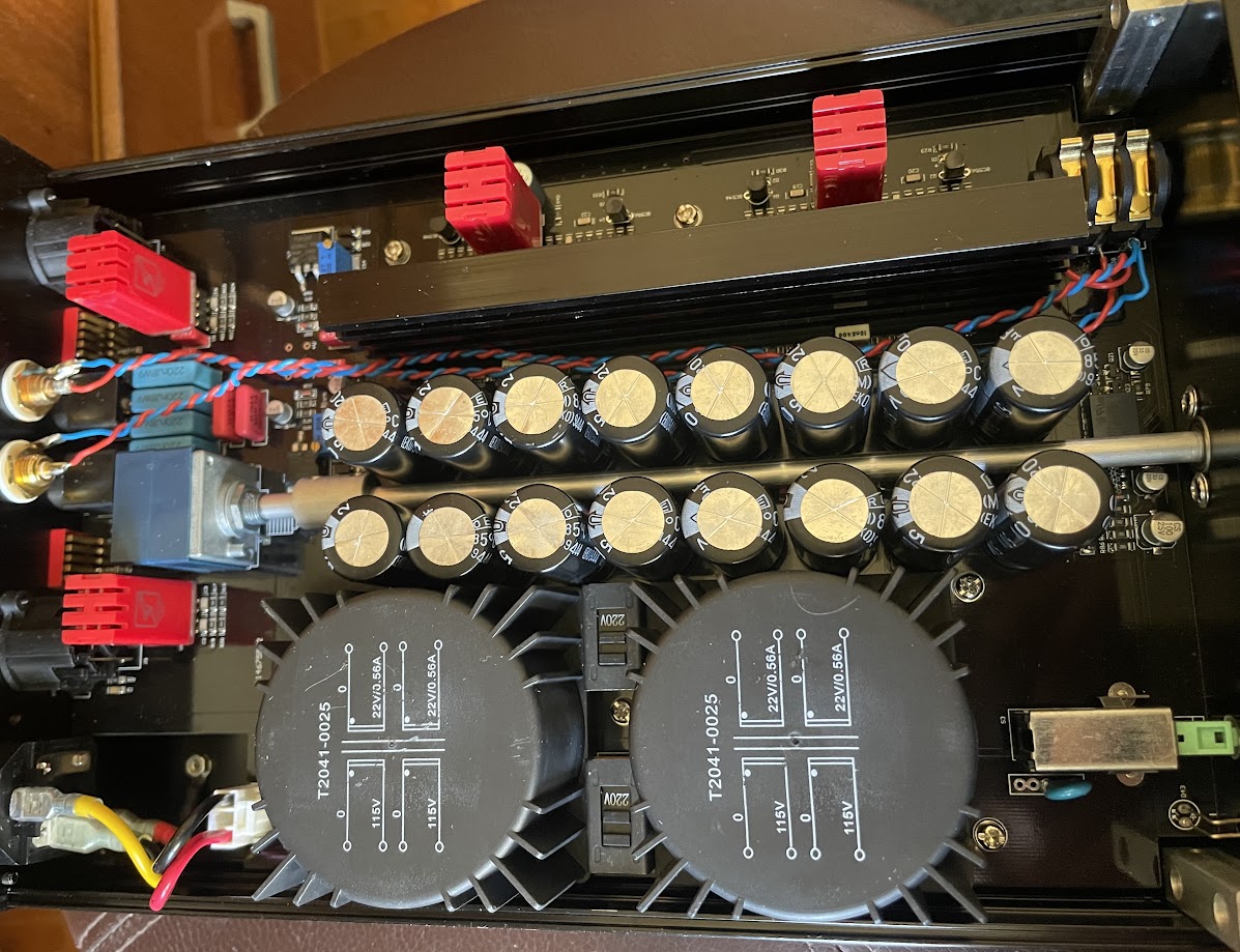

I have now the full boat, sounds good! :jecklinsmile:
ABLVV85Caxi-1nfJFY97P7D12z10k0L-tWO2Cod742L2_O7cH3hCSqh687UdzMTqR0Zzajdv9qwbMIk9hxZOkIloF2HGyn66bWGLtYsmnxPFmy3R_EEsnkk0qEmuZQOsjnKF07ZNEccxW4EgqOcp7JijQsp6=w657-h919-s-no-gm
ABLVV86UiNta63IGQ7OFcPaUOE1eSFfzHNFqKsqhm1L8E3evIyDGhTukipMZ2ys0kbdupxdKA3bqbB_Aw57sn8O61B8_ewspUXuCSHDICeNoWNuZpb_irGg2KoUkRHoHwpPhsJtWuuF6hXaB8vRQJDkSXa8k=w1197-h919-s-no-gm
